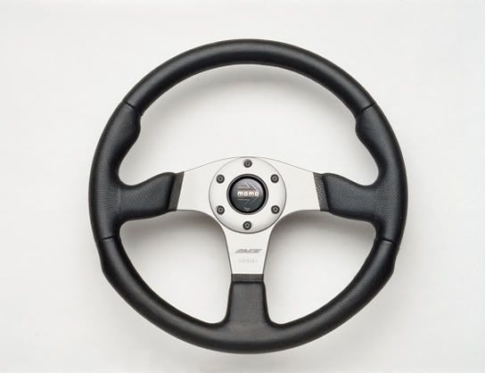

What is the brand name and model of the steering wheel?It's the style I've been looking for on my buggy.

[QUOTE="manxfwin"]What is the brand name and model of the steering wheel?It's the style I've been looking for on my buggy.[/QUOTE] Dave , It is made by MOMO . The model name is "RACE " I had to order the one shown in the photo from Italy to get the small diameter but the larger diameter "RACE" wheel is still available in the USA I believe.They come in a brushed aluminum color and a darker gray color . I ordered the brushed silver color to kind of go with the windshield frame but when it got here it was the darker color . WOW what a drag . I just let it go cause at that point I was just happy to have finally found the model an diameter I was lookin for. Image
