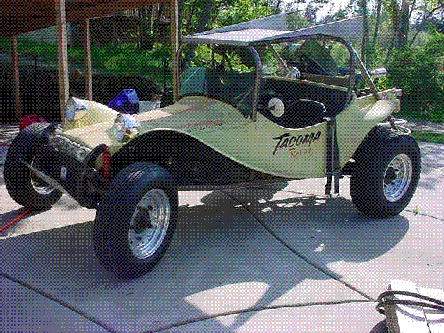

Image........ Image

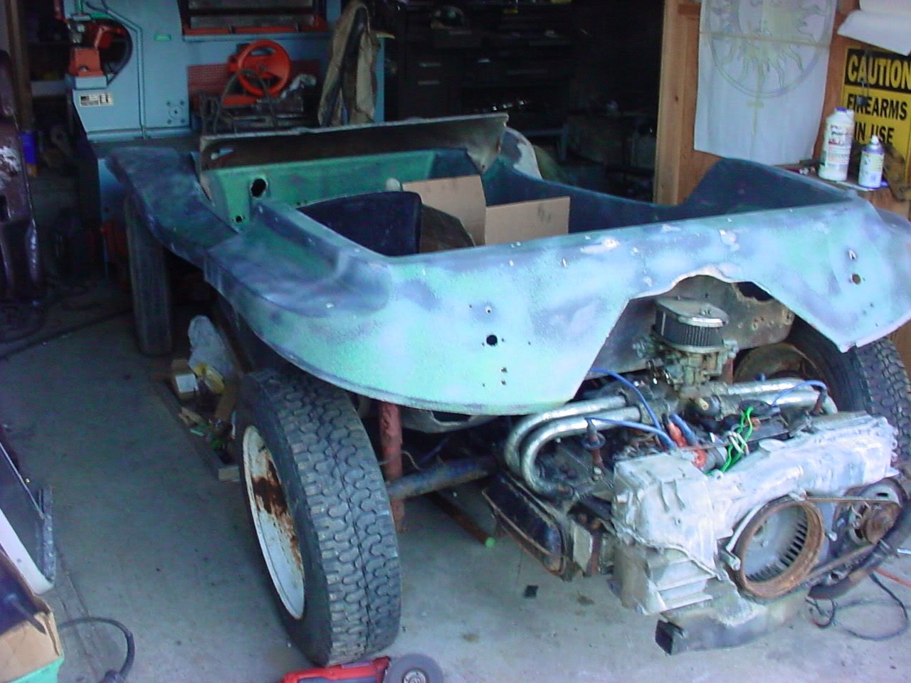

this is the brown bomber from Spokane after walnut shell blast.Image

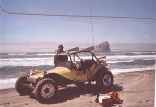

beach trip to Pacific City, Oregon. 2006Image
markmark
Posts: 204
Joined: Wed Jun 14, 2006 8:00 pm
Post by markmark »
Would that be the only Mini T race buggy made? It looks good as a race buggy, I like it:cool:

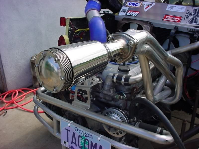

Imagenew air filter

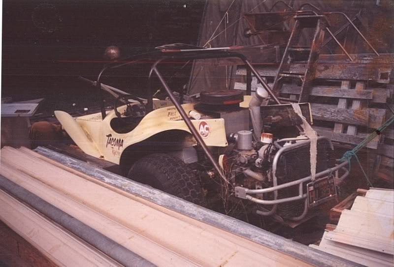

Imagethe first day I met my buggy

[QUOTE="fubar"]Imagenew air filter[/QUOTE] WOW!! :cool: :driving: :cool:

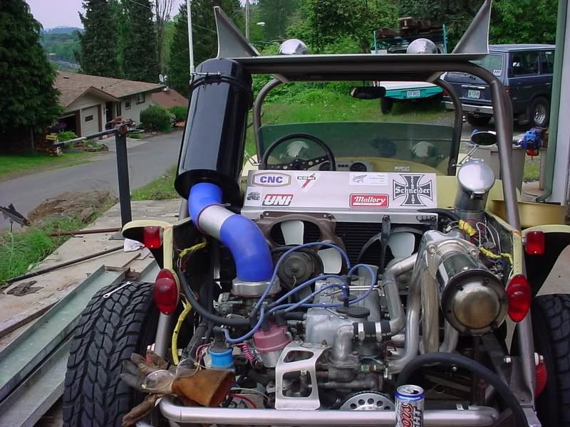

That is a cool looking buggy, any details on what engine it is running and how it cools with the radiator down there ?
fubar
Posts: 425
Joined: Mon Apr 11, 2005 8:00 pm
Post by fubar »
It is a 2tc Toyota engine. It cools fine , there is also a small heater core from a rear heater off a four runner up by the pedals. The heater does very little with no windows. You cannot see from the photo , but there is about a four inch gap between the radiator and the fuel tank with a titanium heat shield to keep the fuel from boiling. That aluminum piece with the decals was meant to scoop a little more air through the radiator. I originally set the fans up with a 40 amp constant duty relay from the fan switch and separated the fans on individual circut breakers. It worked great for a number of years, but it started cooking fan switches and the relay. I think I have a bad fan causing too much resistance? That will be this summers mistery I guess.
