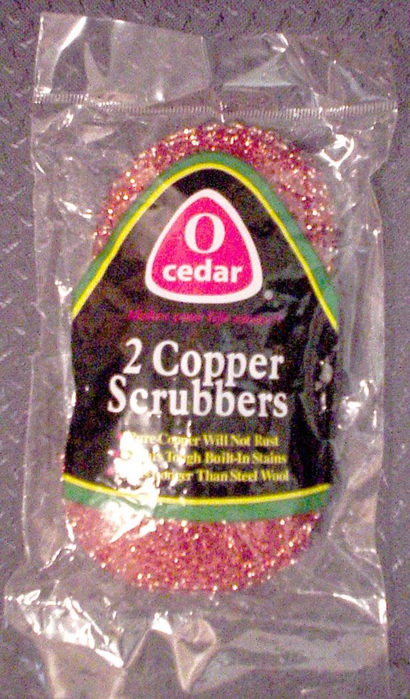

I don't have mine the same way as Jerry does. Sure, a little oil, about 1/8" deep (maybe a 1/4" at the most), will accumulate in that lower section of the breather box. It's probably about a fluid ounce or so. If more than that gets there, like when filling oil, it just runs over the ring fastner into the case. That little amount of oil is not a big deal, in my opinion, but maybe others have different ideas. Here's a pic of the copper scrubbers I found at Walgreens. ($1.99 for two) Jerry, thanks for pointing me to that speciality parts store (Walgreens). Guess we now know how much house cleaning I do, huh?
