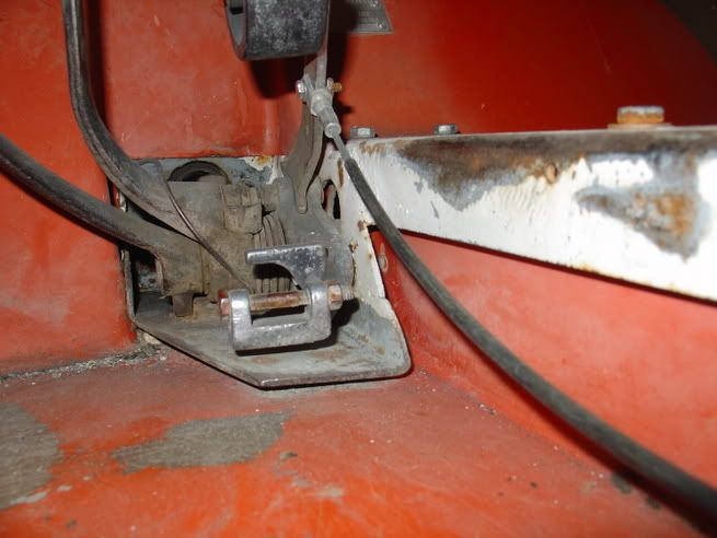

Hi maybe this will help. You can see the I.D. tag up front. Image

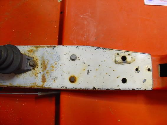

2nd photo Image

These pics are great! Our Tow'd has 4 holes where you have a plate so unfortunately we don't have the serial number for this Tow'd. I did find that Bug Shields as a possiblity to get a new windshield from thanks for that. Now the tunnel issue, if you can get me the dimensions I think we can make one to match the pictures you have sent. It looks like each side has about a 1" lip and as far as length we've got holes already there in the fiberglass that we can use a guide also. But dimensions would be great! I'll have to look at the pics again and see if we can tell how the pedal mount box is welded to the tunnel. As far as getting a pedal mount box, we run a small sand rail, dune buggy, VW shop here in Nebraska and we get these in for our sand rail chassis so I think we should be able to make one of those work. Thanks again for the help I'll probably be back with more questions............. Shauna

Photo of top Image

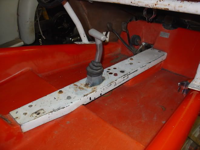

Note front not square Image

These pics plus the diagram you drew should give us a good base to fab a tunnel. Thanks for your quick response and all the info. If there's anything else you think of that we need to watch for or do while we are working on the Tow'd let me know. I'll try to post some progress pictures as we go. I knew this was the place to find some help!!!!!!!!!!!!! Shauna

I think the console in Old Towd's picture may have been a replacement. I've owned two Towds and neither of the consoles tapered toward the back like his. Also the sides of the metal console were shorter than his and there was no need for a cutaway to clear the seat. On my metal console the sides are 1 1/16" long, from the top face of the console to the bottom edge of the lip. His are an 1 1/2" long. The inside width of my console is 4 1/8", its whole length from front to back. Does any one else have one that tapers like Old Towd's?

Wow CairoManx,your right there are different consoles. I looked at some photos I had and you can tell there are some narrow and wide ones. I never thought mine wasn't original it looked so old and sad. Mine being wider has to taper in or it takes up seat room. I wonder if Bruce can clear this up for us or all you tow'd owners take a look and see which one you have and I'll try to dig deeper into this. I surely don't want to send someone down the wrong path.
