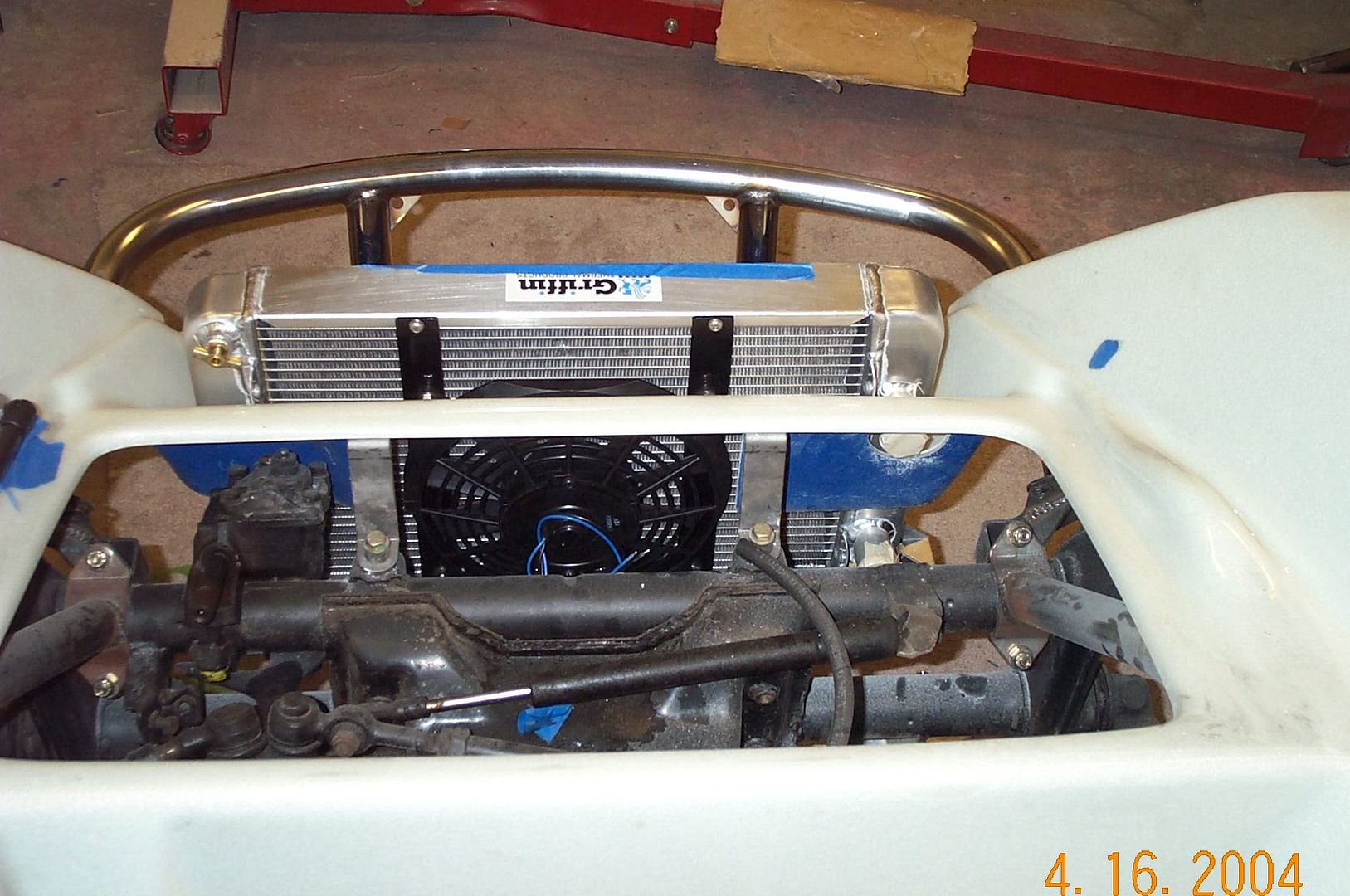

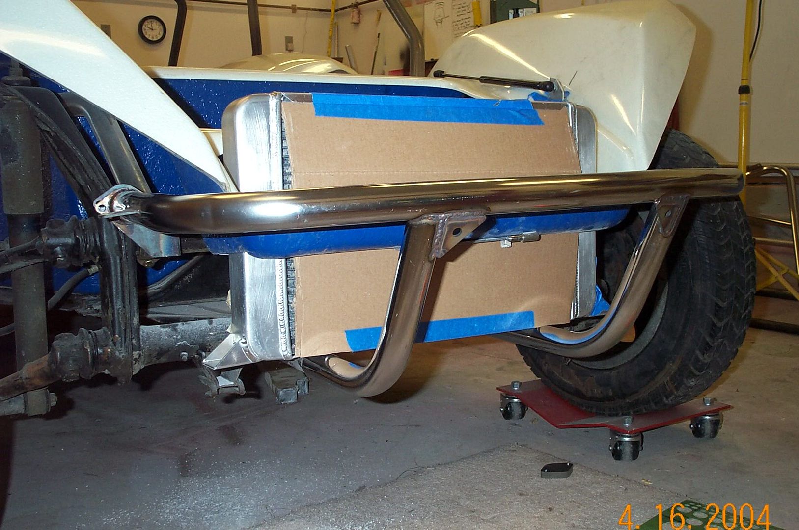

Olli, What kind of radiator are you going to use and where are you mounting it?

I had Griffin custom make one. It fits up front. It mounts to the front bumper cage in a vertical fashion and comes up inside the hood. That really is a poor description, I will post a picture when I get a chance. It actually fits quite well. The coolant lines are 1.25" aluminum tubing for the majority of the run. I found that running the coolant lines through the sidepod (passenger side) the cleanest approach. The other reason is that up front the steering is on the left side, so all the room for the coolant lines was on the right side. For that reason, I had Griffin give me the fittings all on the right side. This eliminates criss crossing up front. Olli

These pictures do not show the stainless mount ears that are welded to the bumper tube now. Image Image

I have 3 questions: Did you give any thought as to where the heat/hot air from the radiator is going to go? Is your fuel tank going in the stock location? Is the petcock on the upper left of the radiator used to bleed off air?

Jerry, 1. yes 2. yes, but not a VW tank, fuel cell. Are you thinking that the warm air might warm the fuel too much?? 3. yes, that petcock is an air bleed. Olli

I'm not sure of the the way a Manxter is put together in comparison to a regular Manx but if it is close to being the same , the heat from the radiator would come into the passenger compartment over the top of the "toe board" . Just a thought.
