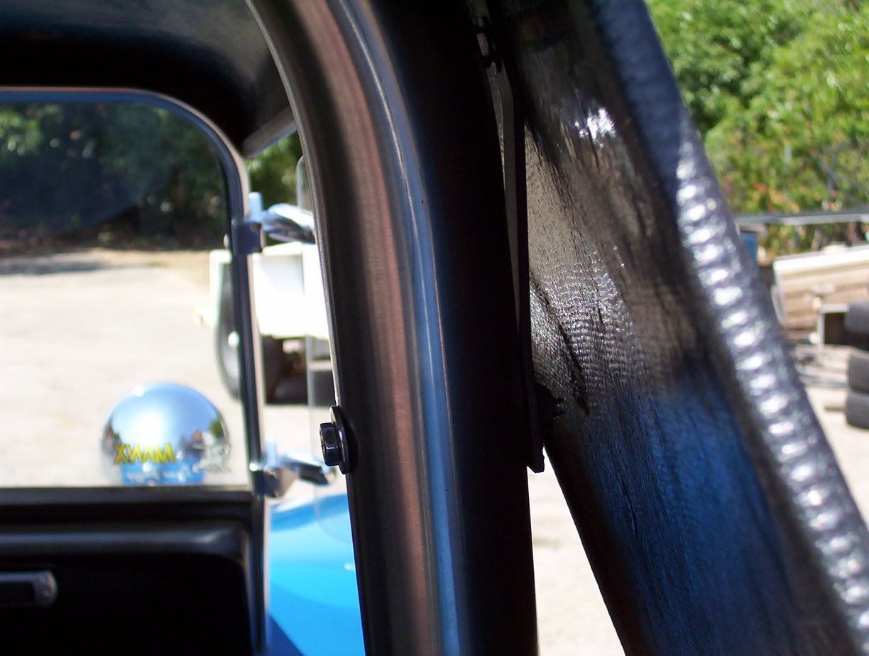

The front of the hard top fits over the front lip of the windshield. It does not go into the windshield groove:

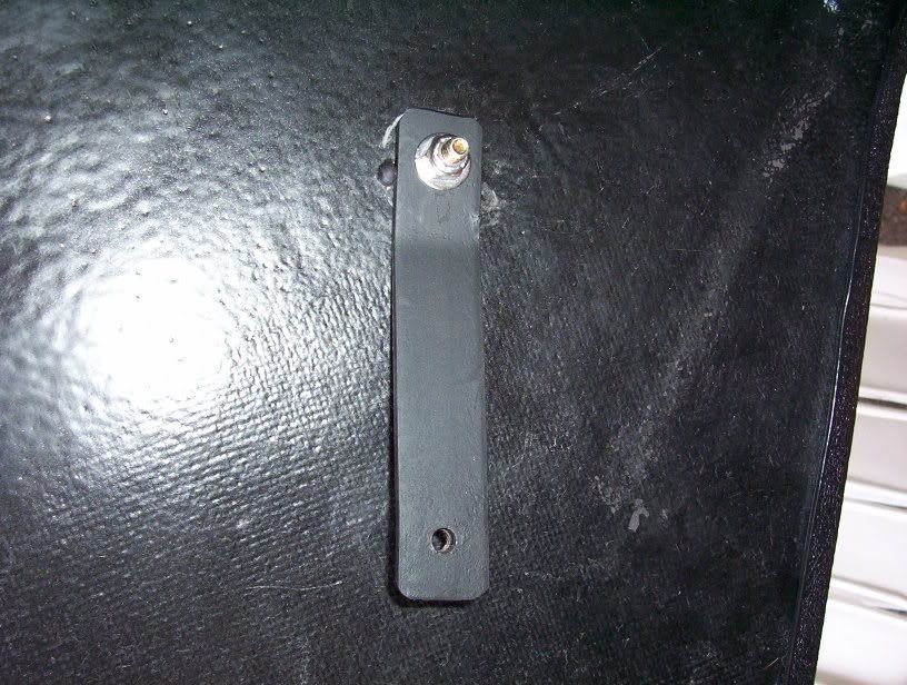

There are aluminum straps that get bolted to the insides of the rear 'ears' of the hard top. I used the originals as patterns to make steel versions:
If you look closely in the above photo, you can see that the bottom hole is threaded. I welded a nut to each new piece so it would be easier to get the bolts in and out. The bolts go through holes you have to drill in the roll bar:

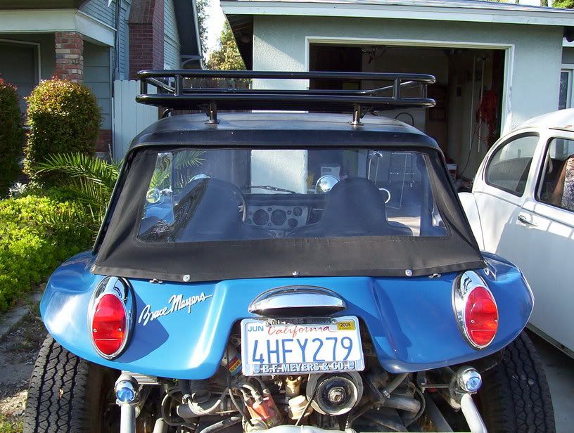

I wanted to incorporate a roof rack to go with my hard top, and I decided it would be best to sandwich the top between the rack and the roll bar. I got a couple of those rubber spacers that are used for shock reservoirs and cut them in half. This gave me pieces that were flat on one side and curved on the other. They fit fine between the top and the roll bar, thus filling the gap (sorry no pictures). I put stainless steel U-bolts around the roll bar and through the top / roof rack feet. This holds everything down very tight!
I then had an upholstery shop add a rear window:
At least that's what I did... Please let me know if you need any clarification or additional photos.
