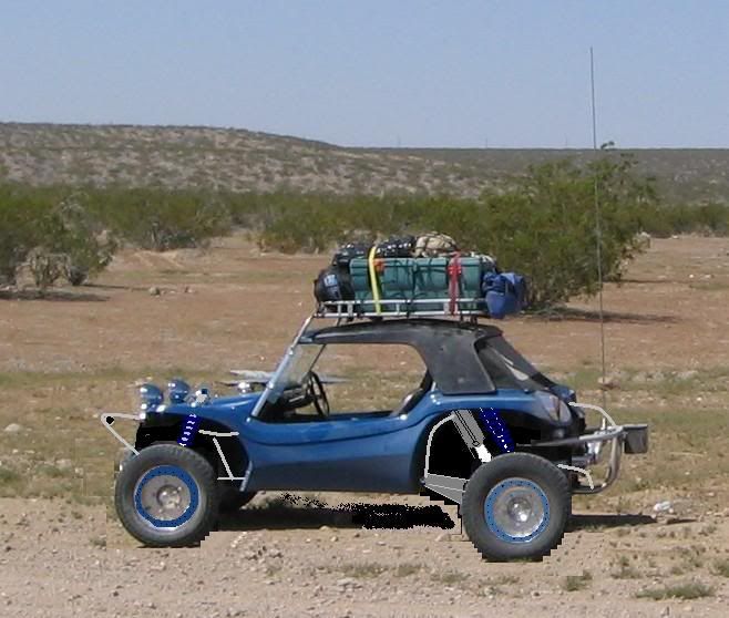

Fox shocks for me! You can rebuild / revalve them all you like. Once they are tuned in, the suspension works GREAT! Only took me four years, but that includes working on the front and rear torsions as well. To answer the question, yes, the front shocks MUST be setup very soft, but the rears are a lot more forgiving. I actually had to stiffen the rear shocks back up because they were originally set too soft - I had been compensating for the binding urethane spring plate bushings. I installed stock rubber bushings, and the suspension can actually move! When it's time to get serious, it will be Fox or King coil-overs, but I doubt I will ever get that serious. Certain friends of mine, well that's another story! Here's the Speedee Fabrication rendition of what my buggy should look like: Image
