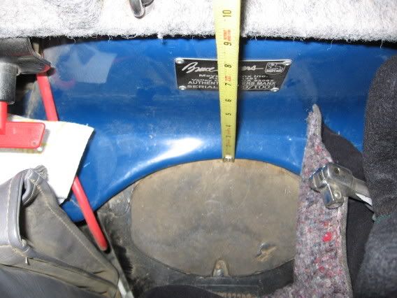

Scott, My roll bar is mounted using the 'standard' method outlined in the Siggy Manx instructions. I can't be sure where you are taking your measurements from, so I checked the distance from the top of the tunnel to the top of the roll bar. I put the end of the tape measure on the access panel that covers where the shift rod coupler goes:

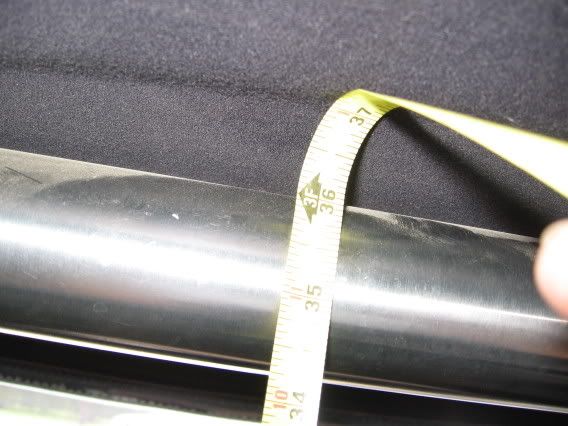

Like you said, you have to measure at an angle. The top of my roll bar is a little over 36", say 36-1/4" above the top of the tunnel, angle included.
If you are close, you should be fine. There is a good amount of slop you can play with if the roll bar is a little above or below 36". If you do get the hard top, let me know and I will tell you how to mount it a better way than 'normal'. Now I am off to clean up all the dust the photographs revealed.
